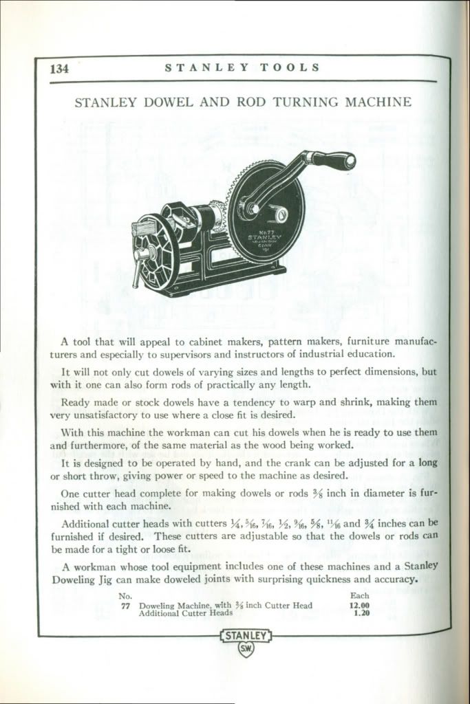

Good friends are priceless! I had a wonderful Christmas as well. I'll explain that later. Here is the page from the 1926 catalog. Your infeed disc is a little different than this.
