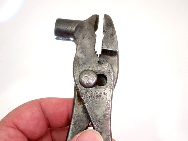

I bought these because they reminded me of the old "Washington" combination pliers (patent #871,585) with the hammer pol along the edge. These pliers are similar, but are slightly smaller, and stamped "Red Devil 1225". But when I started researching, I found that Crescent Tool Company acquired the Red Devil line back in the late 1920's, and the only old advertisements and photos I found of the "1225" were of pliers with no hammer.
So my question is, are these the genuine article, or has someone done a very good job of fabricating?

Genuine, for sure!
Re: Old combination pliers, genuine or no?
« Reply #2 on: March 28, 2016, 08:35:52 PM »
It sure looks like the hammer is forged as one piece with the plier jaw.

I'd vote for "special order" with the hammer poll & the "v" shaped jaw instead of two "flat" jaws with the wire gripping notch running the length of one jaw.   They certainly wanted that "v" jaw hard & got it so hard it was brittle & chipped.
Don't know why they'd go to the trouble of putting the RED DEVIL # on a special order piece -- maybe just a bit of subtle advertising in case someone asked, "where'd you get that made?"

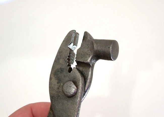

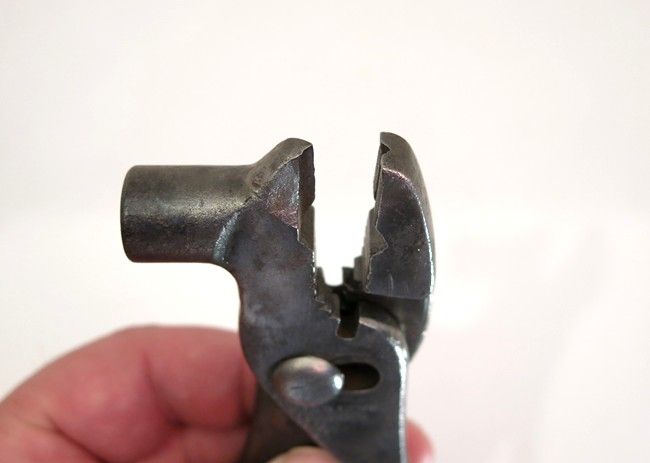

TIG weldor with a kid like Nola on a 7" grinder for 10 minutes.
You guys have no idea of the things weldors do to pliers, screwdrivers and wrenches.
Usual tipoff will be the enhancement won't be centered.
You can see the weld in the one pic, at the jaw end of the pliers.
Kid on the grinder was awake that day too.

Looks too good to have been done by a welder with a grinder, I'd have to go with a forging.
Blow up the picture of the jaw and you see the weld along with the crater full of dirt.  Looks like a TIG job to me.
Acid test would probably display the weld even at this point in time.
