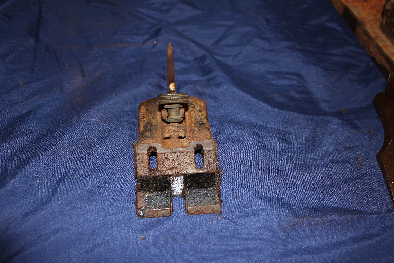

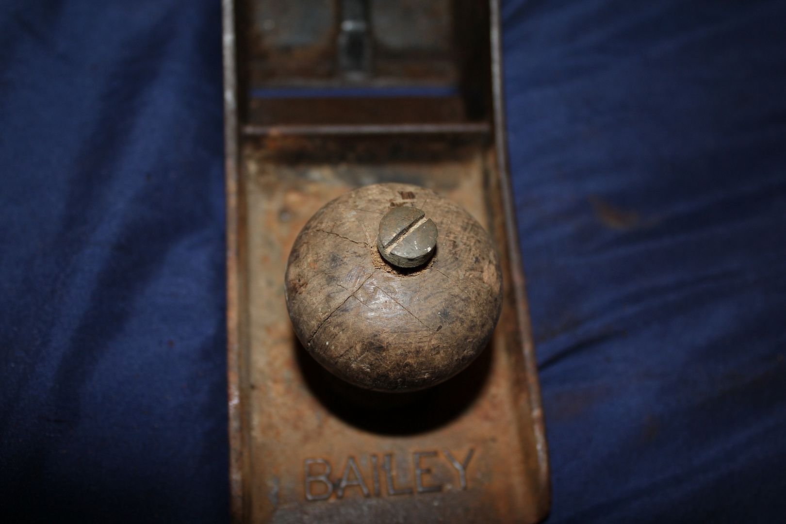

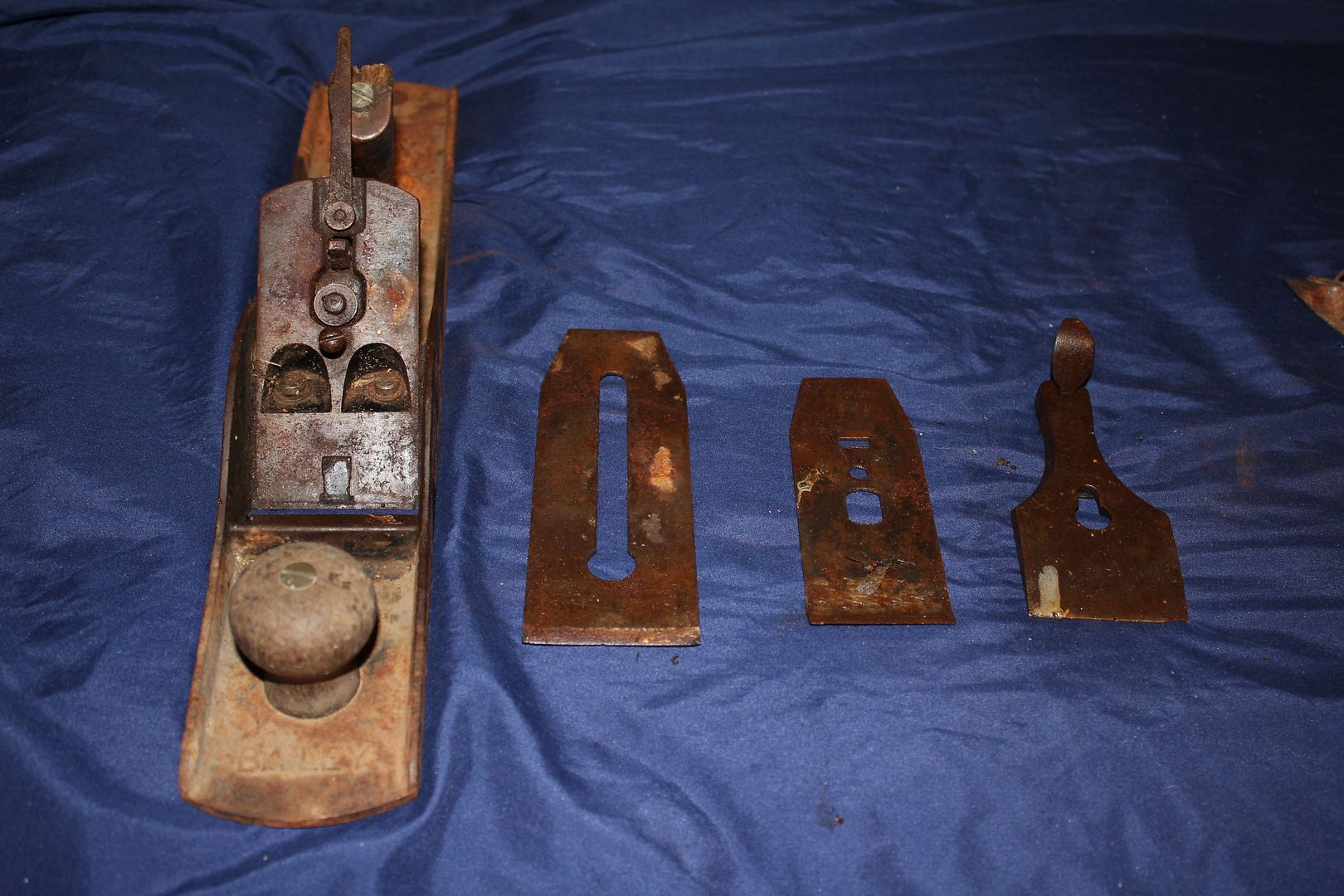

I am not a woodworker and know zilch about planes. I never want to collect them because there is too much to know in order to do it right.
Friday at a garage sale, a fellow had this plane on a table and asked me if I knew anything about it. I told him I could see it was a fore plane and a corrugated model, but that was all. He wanted a value and I told him I didn't think it was worth much, especially to me.
Grungy, rusty, broken tote and cracked knob, all spoke junk to me.
Guess what? He agreed, and insisted on giving it to me. Can't refuse free old tools can I ?
Some research- http://www.supertool.com/StanleyBG/stan0a.html tells me it is a Stanley Bailey #6C fore plane from after 1910. That is all the research I intend to do. I shot photos, then took it apart.
Worth anything?

I think the screw holds the chip breaker to the blade so you can set the chip breaker to the blade and then set the blade to the plane. Like you I don't know much about Stanley planes.

The one you mention is there, but the one I'm talking about was in that depression just as you see it in the photo. Not screwed into anything.

Probably  a screw from another plane. Only one is used on each plane.

Papaw,  there should not be a screw in the depression.  It is just a space for the screw head holding the chip breaker to the blade.

You don't see as many #6 planes as you do #7 planes.  The #6 fills that small space between the #5 1/2 and the #7.   Maybe that gap was too small to bother filling for most.   I think this one could be made into a decent user.  Are you interested in selling it?  I have that gap in my Stanley planes.

It will be a while before it's photogenic -- I've accumulated a number of tool projects that have to be interspersed with actual work.  (I do have the Record table vise I got from Bill all loosened up and serviceable now.)  The knob responded nicely to a couple of applications of 50/50 linseed oil and turpentine.  I'm toying with the idea of repairing the tote, but it may be a complete basket case.  I swiped the blade across a stone a few times, assembled the parts and gave it a try on a piece of wood -- it works.  Stanley Blood and Gore thinks the #6 is near useless, but a wood worker I know thinks they're ideal for panel raising.  He likes the extra weight over that of the jack plane.  I think I'll be on his side when it's all tricked out.
