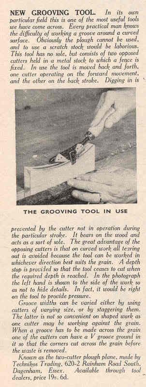

« Reply #3 on: March 21, 2014, 02:47:32 AM »
My PC playing up, cannot post an image - see: http://i56.photobucket.com/albums/g190/mirboo/Woodworker%20Scans/WoodworkerDecember1960d.jpg
From a 1960's Woodworker magazine - shows the maker as British..
