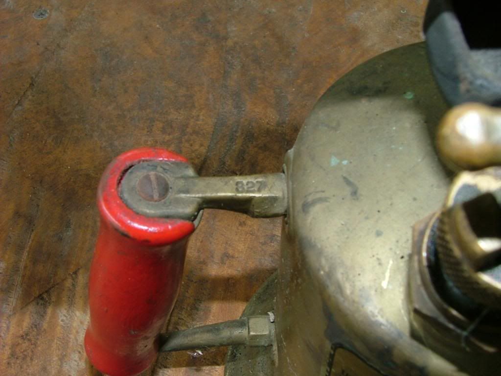

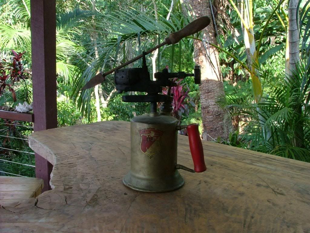

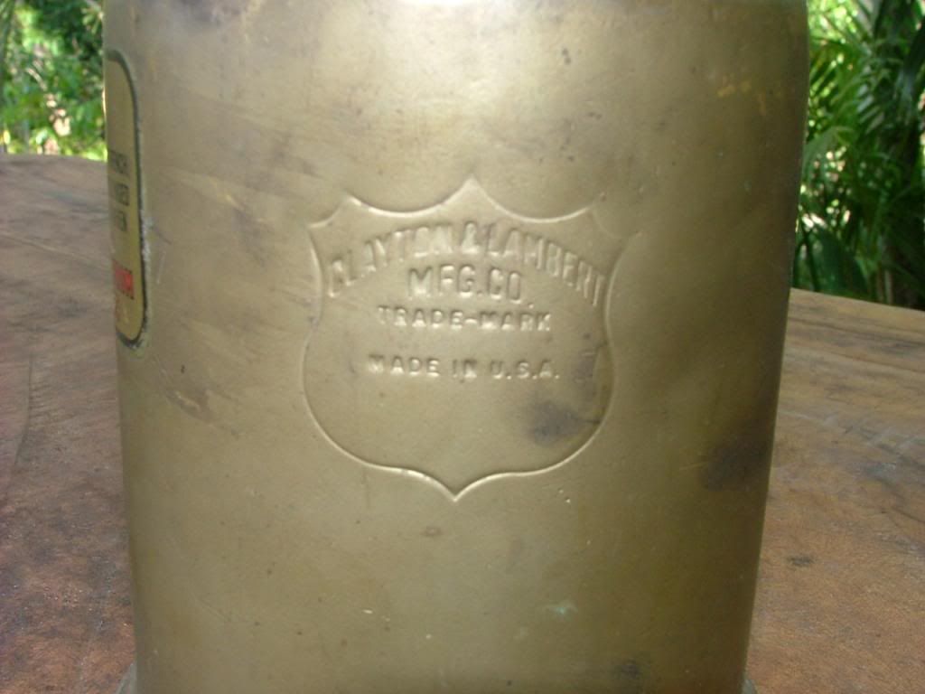

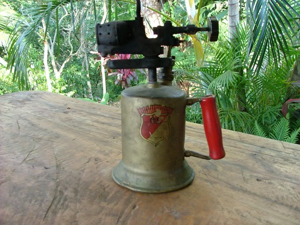

This is a fairly typical C&L torch, this one I have restored to working condition. Yes I do use it in my shop at times. C&L logo is still visible.
Most C&L torches have the shield stamped into the tank. Older models did not have this.
Again most C&L torches will have the model number stamped on the top handle support. This one's a No. 327 (c1952)
Just out of interest, the hook on top of blow torches was to hold a copper soldering iron not to hang up the torch.
