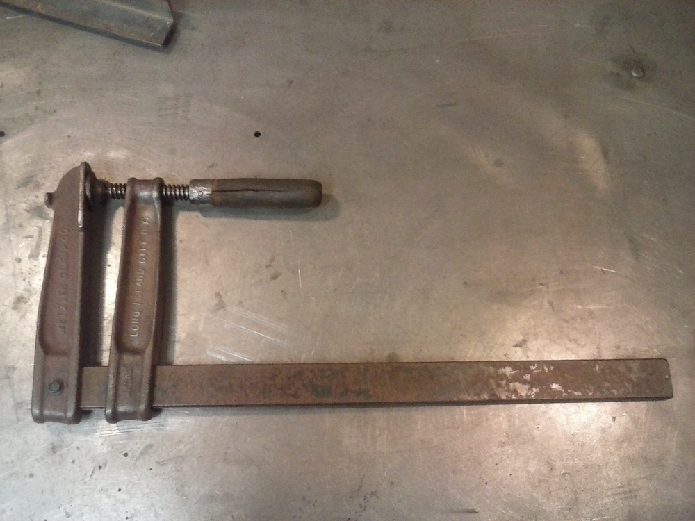

  I think this was in a big box of stuff my neighbor gave me.  The screw was rusted and jammed tight against the metal handle ferrule.  The lower jaw (the one with the screw) was bent to the side and twisted.  For a few weeks it served on the floor as a stop to keep the chipmunk from coming into the garage where a piece of gasket was missing on the roll up door.
  I freed up the screw, disassembled the parts, lightly wire wheeled/brushed everything, then brought it to work.  I put the lower jaw in the vise and "untwisted it" with a large adjustable wrench.  Then I grabbed some metal blocks and went to the hydraulic press.  It took about three different bends but I got it to line up correctly.

While researching Wetzler I found this site http://theclampguy.info/site.htm.
Why is there a small anvil-like thing cast into the top clamp piece?  It seems like its there to hit with a hammer?  Why would that be necessary?
I asked that question on another forum a year or so ago, and someone pointed out that the little bump is level with the clamp head at the bar end, so that, if you set the clamp on the floor on its head, it won't fall over as easily.  Once I understood that, I noticed they appear on a lot of different makes of clamps, but not, for some reason, on products of the Adjustable Clamp Company (Pony, Jorgensen).  Pony bar clamps will, in fact, fall over when set on their heads, which can trigger the environmental hazard of the air turning slightly blue if you're in the middle of a glue-up when it happens.

« Reply #9 on: November 06, 2018, 11:57:02 PM »
There have been many times that I had to use a clamp to push bearings or a shaft into another piece. Many times I had to hit the clamp to unstick the piece being pushed. Same as a gear puller, tighten it and then shock it with a hammer to loosen the pieces.
