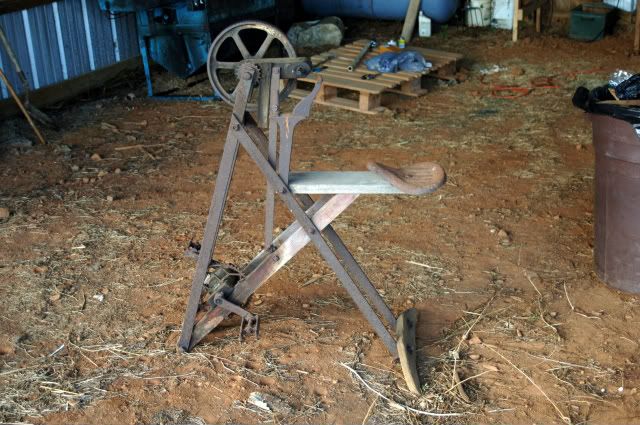

Here is my next restore project.
It is a small grinder that you sit and pedal.  I'm going to take it all the way down for a complete restore.

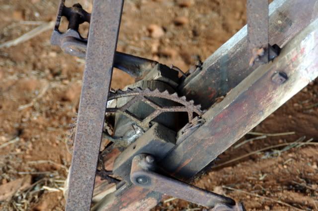

This is the pedal and chain sprocket.

Now that is one interesting piece of home brew work.   Bet it was made on a farm before electricty, (pre-1938).   Mixing wood and steel components, and that bicycle sprocket from the 20s or 30s,  repurposing and making do.  I really like how he carved wooden bearings for the pedal crank.  Glad it survived.  Going to paint it?

That's a honey.  What do you suppose he used for the tool rest?

 Looks like a factory built tool to me. very nice.

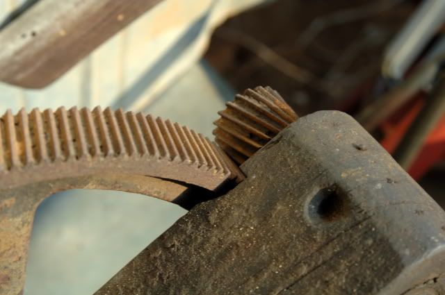

What a great bit of history, I think it is homebuilt, but whether its home or factory built it is certainly very old and certainly well made using what was to hand.  The cranks are locked with square head set screws, never seen that before! I thought cotters went back to the begining of the safety bicycle? The larged helical gear wheel and pinon,look like they are  out of an early forge blower or cream seperator?
I think with that sort of gearing you would know that your working!

Close up of helical gearing.  The small hole is for oiling the shaft.  There is another one for the large gear.  The shafts are in metal sleeves.

Better view of the lower sprocket.

Now that you mention it that big gear does look like the one in my old IHC cream separator.   I think home made when I see the mix of wood and metal parts, a wide variety of screws nuts and bolts.  That tool rest looks familiar, am thinking still on that one, it reminds me of the brake pedal of a high wheel wagon.  Glad its going to be saved.   Ingenuity!  Here is a pic of a 1920s KeenKutter pedal grinder, different with the big stone, but the general layout and the seat sticking way out there is similar.  As I was taking mine apart, discovered that for shipping, originally, the whole thing could fold down (minus the stone)  to a 4 inch high box.

The diagonal wooden pieces with bearing blocks make me think of a wheel barrow.....
The mix of strap iron and rather fine castings makes me lean toward homebrew as well, very interesting piece....
The piece the tool rest is bolted to looks kinda like a wood stove foot.....

I can see that.  The big gear looks a lot like the gear wheel on a small forge I got a while back.
