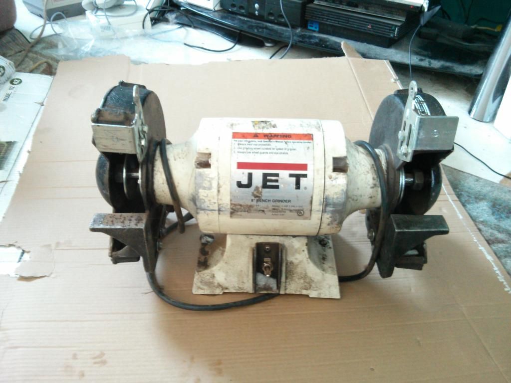

My local metal yard has a big pile of discount junk fairly regularly... Last time I was in, a JET 1HP bench grinder was in it. They tell me the motor is burnt out in it, but that's as specific of information as I've got, aside from the fact that the arbor still spins freely.
So, I'm curious... is it something that could theoretically be rebuilt for a pittance? I realize it can't be diagnosed and pinned down with as little information as that. But, in general, how repairable are bench grinders?
I'm guessing not very, shy of brushes and switches. Rewinding is probably expensive? But, I just don't know that much about them... I'm pretty mechanically inclined though.
Thanks

if the winding is burnt, then you would need to replace the insulted copper wire that makes up the start and run windings, now it could just be a relay or capacitor.

I checked out JET's website, and they've got an exploded diagram with list of parts, and prices... the only thing that's stupendously expensive is the stator/winding, at $200. Everything else is less than $60. I didn't ask what they wanted for it, but I will when swing by today. If I can get it for $20-ish, I'll take it.

Well, I paid a little more for it than I would have liked... but I'll tear into it momentarily, and find out if I bought an expensive paperweight, or stole an expensive grinder :P
It buzzes loudly when I plug it in, and hit the switch o.o

BUAHAHAHAHAHAHAHA! IT WORKS! IT F*ING WORKS! XD
I don't know what I did... but I took it apart, put it back together again... and it works! XD $250 grinder for $40! Pretty good day!

good chance the relay stuck open, when you took it apart it has started working again, if it was me I'd get a new relay and capacitor just make sure it lasts! manual here

If it acts up again give one of the wheels a spin it'll probably come to life.

when it does that the problem is in the start side of the motor winding. Usually it's a loose connection somewhere or the cap going bad or the relay sticking. In your case if it keeps starting ok than probably a loose connection.
