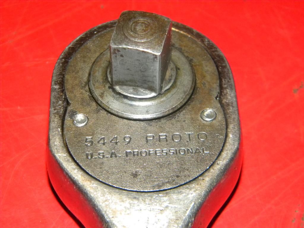

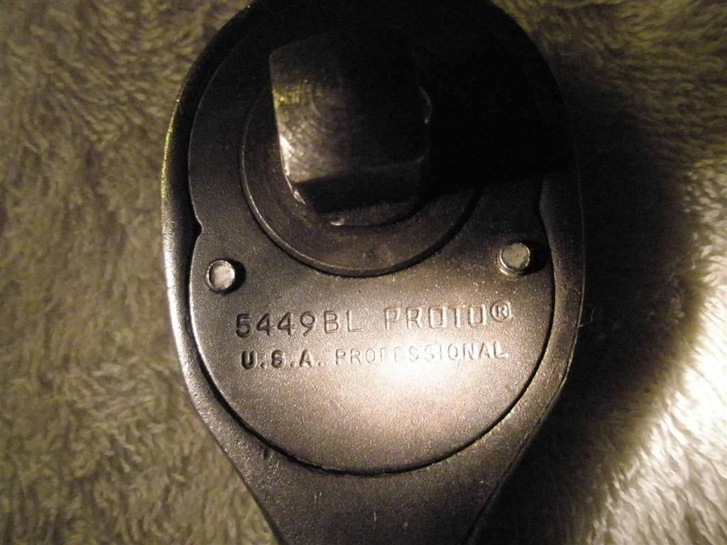

Time to eat some crow. After some more in depth research on the net about Proto 5449 ratchet face/side plate markings, it seems my Proto was made some time after 1984. Witch is when Stanley acquired Proto, if my reserch is right when Stanley acquired Proto they changed the lettering on Proto tools. From slanted "P" and "R"s, and block "O"s, to plain lettering and round "O"s, and they dropped the ®. So my rat is not as old as i thought, thanks to EvilDr235 for bring my attention to this, and prompting me to do more research into the history of these neat tools. The most important thing is to put the correct info out for those that maybe looking for it. I will update the video description accordingly.
Here are some pictures for reference. The top is from some time before 1984, and the bottom is my ratchet. Note the "P", "R", and "O"s.

I see you have a black chemical finish ratchet. I have a 3/8 inch one and a 1/2 inch one. You don't see them very offen. I found both of mine in a pawnshop about 10 years. Both are new and unused. I have never found a used one.
