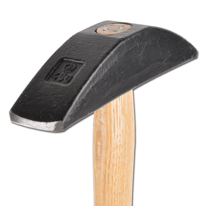

Not arguing with that (much!!) - but in Europe these are often designated and sold as scythe peening hammers - this type not seen in the UK. the closest would be a tinsmith's creasing hammer:
In the UK a raising hammer is more like this....
 a search for dengel hammer finds many similar, e.g. http://www.esska-dk.com/esska_dk_s/Dengel-Hammer-med-handtag-2-Pin-943094019261-12610.html
Danish
But I do agree a hammer designed for, and used in, one trade has wider applications in other areas...
Note in Europe there were probably as many variations in hammers shapes and anvils as there were patterns of scythes - i.e. hundreds...
