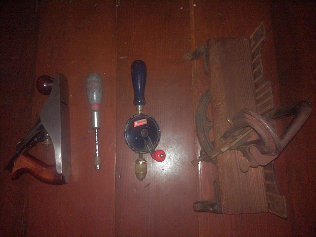

Wanted to show some of what I got at the flea yesterday that I especially enjoyed acquiring...
From left to right:
Stanley -Defiance- [unsure of model No. atm] Smooth Plane. paid: $20.00
Stanley -Handyman- No.133H Yankee Screwdriver. paid: $2.00
Stanley -Handyman- N0. H1214 Geared Hand-Drill. paid: $1.00
Stanley No.150 Miter Box. paid: $15.00
I have only gotten around to cleaning up the Plane so far. The paint and lacquer is good on all of them. Exposed in a lot of places sure, but smooth and should be easy to touch up after a bit of light sanding. They are all in full working order, as well. Over all I was pretty happy with this. I also got a good amount of other things but none of them are either worth showing or belong on this specific board.
I think I paid a bit much for the plane. And, I know I could have got the miter box for $10.00 if I really pressed. But, I liked the guy selling it (also got the plane from him). Because, he knew everything he had there really well and I learned about a few tools I had not seen before from him. The screw driver and drill I got at 2 other spaces. And, I think I did well on those (enough to makeup for having not done so well on the plane and miter box).

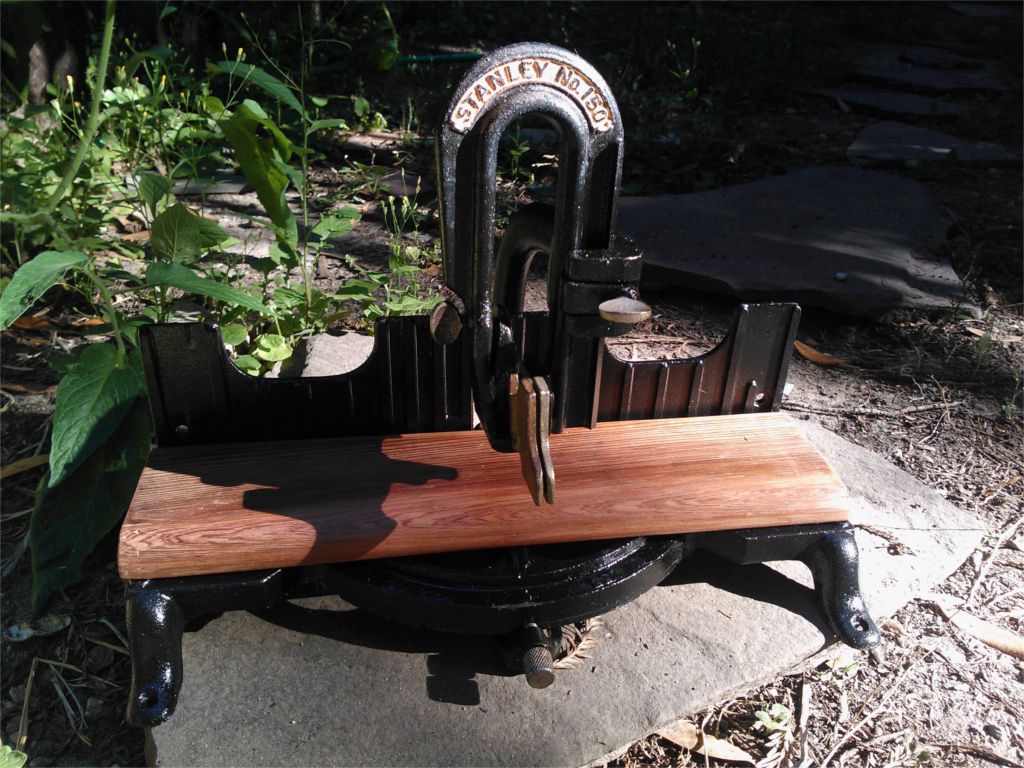

Yeah, I do feel like the miter box was the best find for me this go around. Cast Iron with those Nickle-plated steel hardware(I think Nickle-Plated given that zinc coated look but with amber colored aging instead of that dusty grey). And that redwood table on it. It looked good even before I started cleaning it up. I'll be done cleaning it up today (later today as the paint needs to set). I'll post some pics of the results on that in this thread.

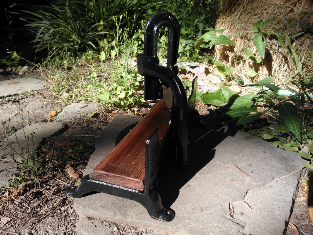

I didn't quite finish fixing it up today. I still have a little touch up work to do and to decide what I want to do with the lettering (I just smeared the orange and white I got on one side to get an idea of how it sits on there for the moment)..but here are some pics at its now mostly finished state.

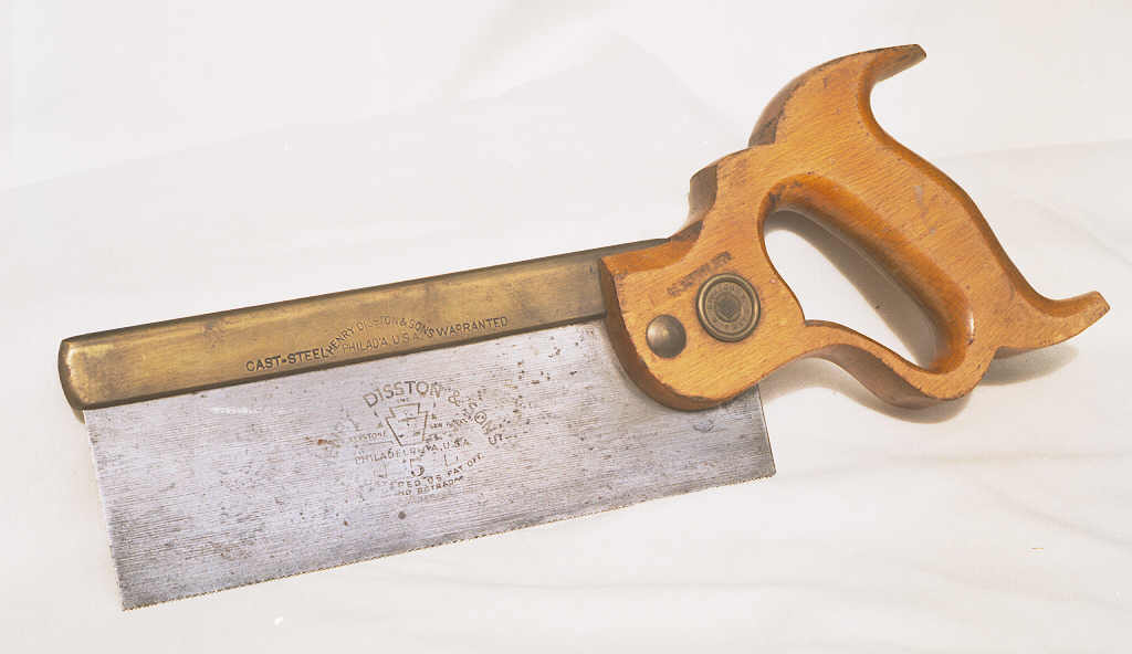

(I should also mention that while some I have talked to call the saw required for proper use a miter saw, others call it a backing/back/backed saw. I have always been unclear on which is most correct but here is an image I found with google that shows you what the saw used should basically look like:

That's a beautiful little back saw!   Given the length of the blade, it looks specifically like a dovetail saw.
Back saws come in various lengths and have different purposes.  The point of the back is to stiffen a thin kerf blade.   The proper saw for this miter box would be from 10 to 14 inches long -- otherwise you don't get enough cutting length to do the job.  I have a fairly recent Buck Brother's back saw specifically made for use in one of these boxes that has a 12 inch blade.

  The saw isn't mine, that's off google...it is pretty though, huh. If I find one out picking, Ideally I'd like to find a Stanley Handyman of the right size and type and age to piece appropriate. More likely though this will sell before that point. I have some cast iron legs from a white's treadle base, and some wood that matches up well...So i have been thinking about building a matching table for it.
