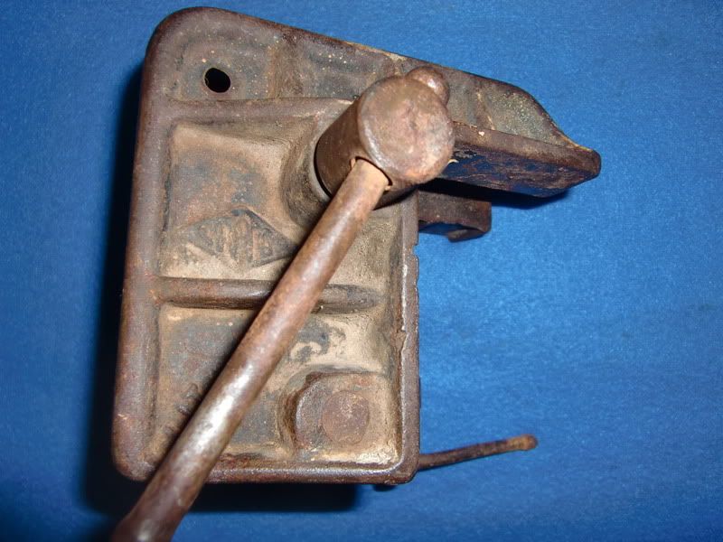

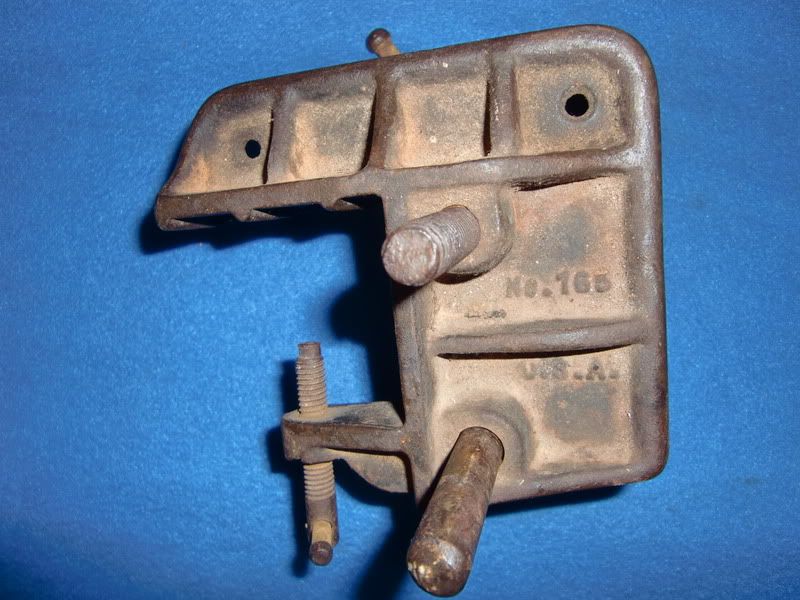

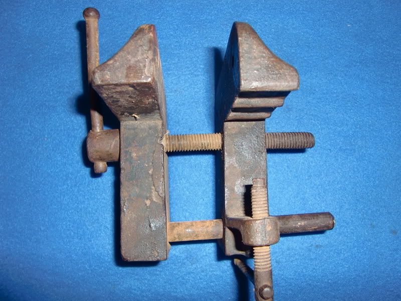

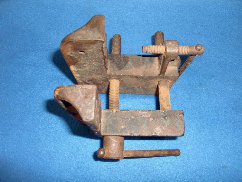

« Reply #14 on: January 14, 2013, 08:35:40 PM »
Find a "cupped" washer- like used to space the shock bolts on a motorcycle- of appropriate size and place it there, then lightly peen the screw so it stays there but still rotates freely.
What he said!!  Here's a couple of pics of my #165. Looks like that is exactly what was done.
